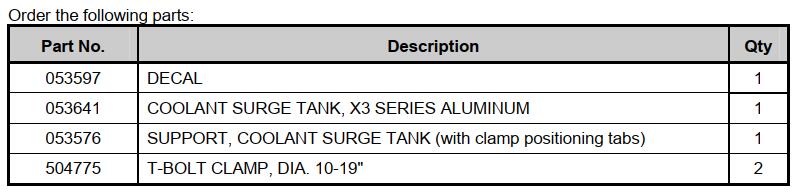

What You Need?

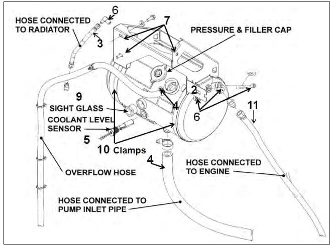

1.Cut the tie wrap holding the DEF lines to the coolant surge tank bracket.
2.Disconnect each hose connected to the coolant surge tank.
3.Place a clean rubber tube into the coolant surge tank. Using siphon effect, drain coolant surge tank.
4.Remove tie wraps and unplug low level sensor connector (5).
5.Loosen all fittings and sight glass.
6.Remove 3 bracket bolts (7) and remove coolant surge tank and bracket. Pull the coolant surge tank through the SCR converter.
7.Turn the tank in order to have the level sensor at the top, in a vertical position and then unscrew it from the coolant surge tank.
8.Remove sight glass and all fittings from coolant surge tank.
9.Loosen band clamps (10) and separate coolant surge tank from bracket. Return to Prevost for full reimbursement.

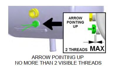

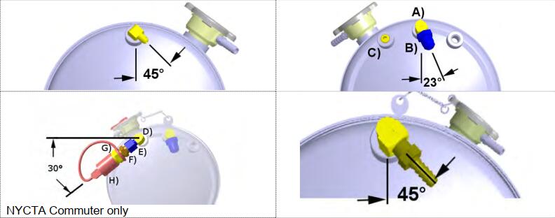

1.Using Loctite Thread Sealant 567 on threads,install level sensor in new coolant surge tank with sensor in a vertical position at the top of the tank. Tighten so that arrow on the side of the sensor is pointing up. Leave no more than two visible threads.

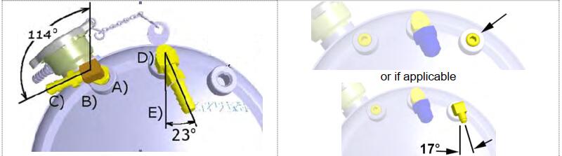

2.Install all hose fittings and sight glass using Loctite 567 Thread Sealant

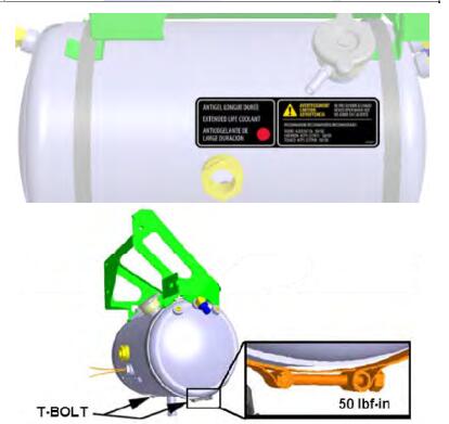

3.Affix decal #053597 on surge tank. For NYCTA Commuter coaches, affix decal #053625 in addition.
4.Fix surge tank onto support. Tighten T-bolt clamps to 50 lbf-in.

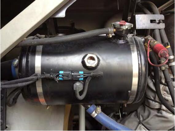

NEW COOLANT SURGE COOLANT SURGE TANK INSTALLLED
NEW COOLANT SURGE COOLANT SURGE TANK INSTALLED – ROAD SIDE
