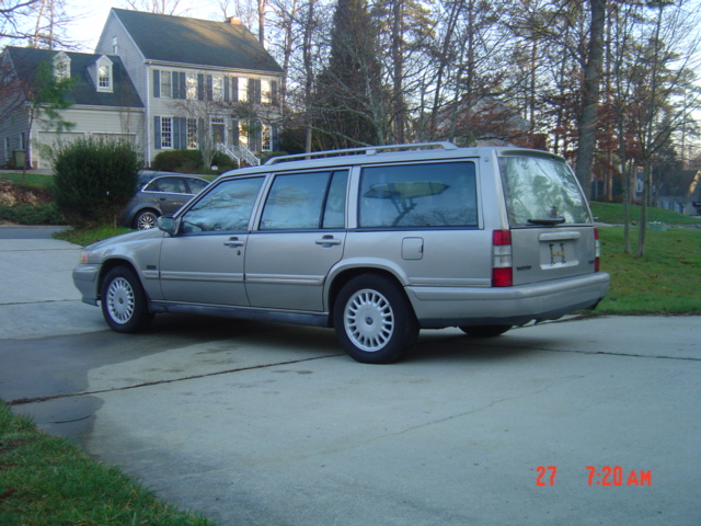

The 960 has the smallest turning radius of any car I've ever seen. Nothing today, in this regard, can compete.
The trick to owning a Volvo is to find a reliable mechanic!
:beer:
(IMG:http://www.terravali.com/testimonials/97volvo960wagonT.jpg)
